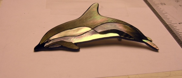

Looks great Hesh.. Here is a pearl diamond and silver pin.
I have a few inlays brewing but really I am in the drawing stages of about 5 commissioned pieces.
You'll get to see those soon. By the way these pins are for sale, so if there's anyone out there interested PM me!

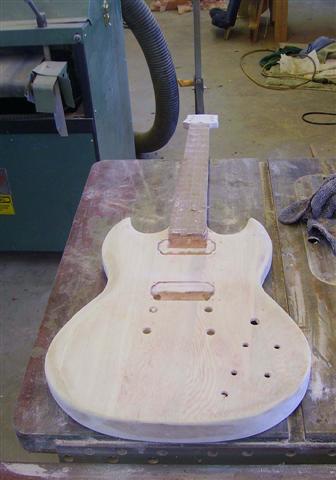

PostPosted: Wed Jul 25, 2007 12:09 am

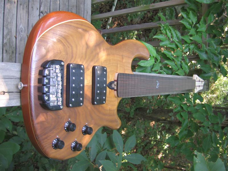

Don't kick me outta here for this...it's for someone else...
PostPosted: Wed Jul 25, 2007 12:17 am
Dang Larry, how many flippin' control knobs does that thing have?

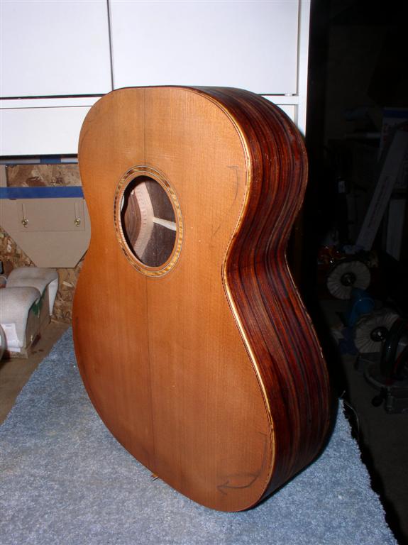

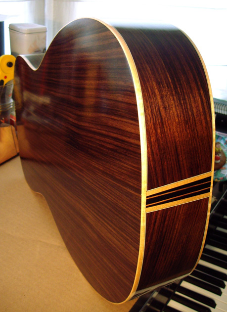

Here is another LS Cocobolo OMFS, the third Redwood/coco combo in the last four guitars.
The back binding went on last evening, so I'm closing in.
Its kinda ugly right now
I have to admit, I am getting a little board with Rewood/coco, I have a few guitars coming up with spruce tops, one with Madrose the other with flamed Hondo. It will be a welcome change

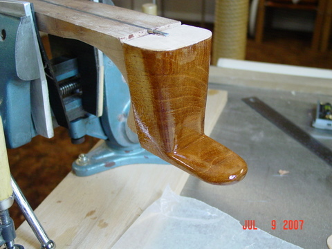

The neck is almost done bar final filling sand and finish.

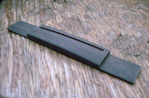

I decided to make the neck/fingerboard width less than on the plan and
then realised that i would not be able to use the supplied pyramid bridge
that comes with the kit as it has string holes pre-drilled (at the wrong
spacing for my new neck) I was hesitant about making the bridge as i
thought it would be much harder than it turned out to be. I traced the
contours from the old bridge and was really happy with the result
especially the saddle slot which i made a simple wooden jig to rout.

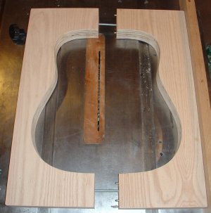

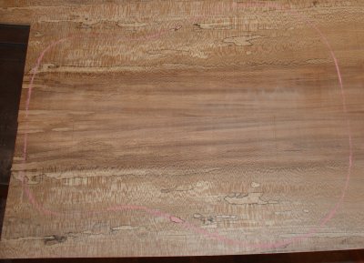

PostPosted: Wed Jul 25, 2007 4:41 am
Posts: 567

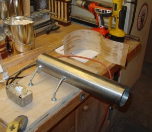

Almost done with my jigs...
side bender in progress.
pipe bender done and tested...
dustless radius dish jig...
body mold...

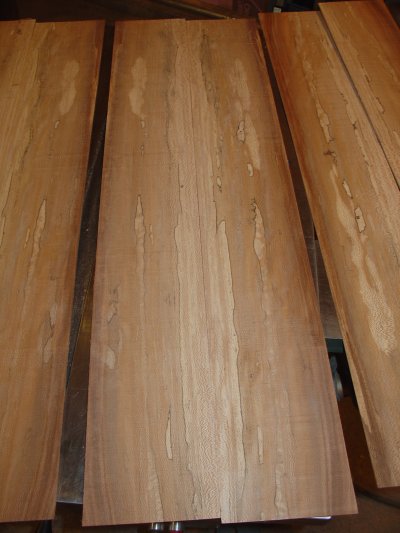

sycamore sides...
sycamore backs...

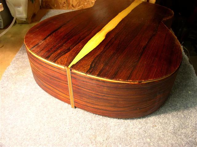

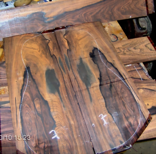

Nasty old Brazilian getting ready to make music!

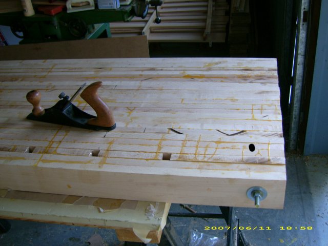

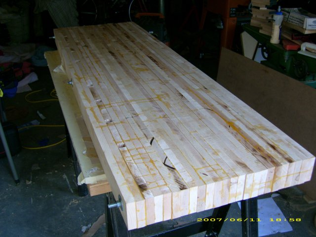

My bench, of course!
I took a guitar break to try and get a better work surface. Here's a couple of pics. I've gotten it rough planed, now I'm working with a #3 to get it smoother, then onto the #7 :)

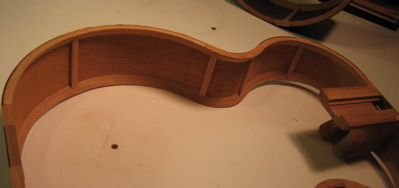

Some laminated sides with laminated solid linings. This rim is so unbelievably stiff I don't think I need to use a mold at all. We'll see...

PostPosted: Wed Jul 25, 2007 8:50 am
[QUOTE=Pwoolson] Dang Larry, how many flippin' control knobs does that thing have?[/QUOTE]
2 vol, 2 tone, p/u selector, input jack...the others are bridge and tailpiece!

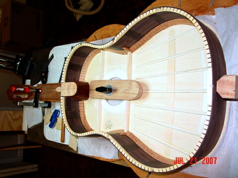

PostPosted: Wed Jul 25, 2007 11:14 am
Posts: 535
First name: Pete
Last Name: Liccardello
City: Eden Prairie
State: Minnesota

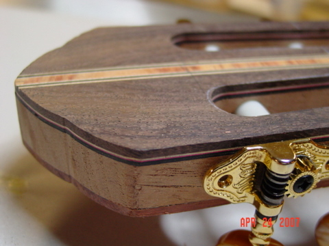

Getting close to closing up this IRW/Spruce flamenca negra made from the Tom Blackshear/Reyes copy plans from GAL.

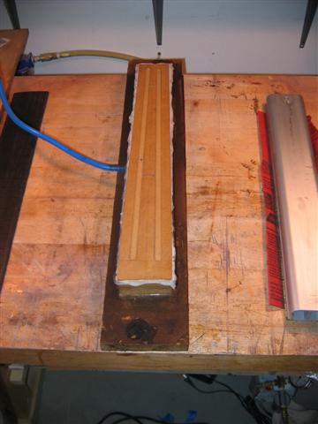

PostPosted: Wed Jul 25, 2007 12:45 pm
Posts: 449

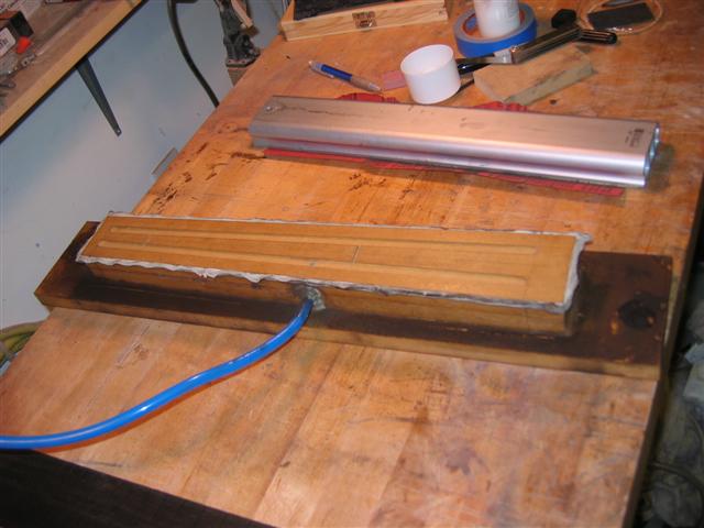

Working on a vacuum clamping jig to hold fretboards flat for radiusing, pressing frets and dressing ends. And, the bottom of the jig works as a flat surface for flattening the back of the fretboard. Haven't tried pressing frets yet, but it works very well with the stew mac aluminum sanding beam which at 18" is a little longer than a 20 fret fingerboard. I was surprised to see how much work was needed to tune up a pre-serviced board.

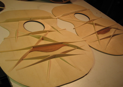

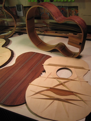

Posts: 1384
I've got two going for the first time. I think I may go back to one at a time for the next few. The first one is a honduran rosewood and red spruce 13 fretter. It will be set up for mediums and hopefully lots of volume.
then an EIR and Lutz (from Shane!) large 12 fretter

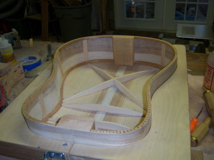

Here is a close up of the tops, I have been experimenting with some different bracing trying to see what it does. The transverse brace runs between the saddle and the pins.
I also did one with double sides (shown here) and one without but both with solid linings. I was surprised that once the linings were in the double sided rim was no stiffer.
These guys are ready to close but will have to wait until after vacation and a much needed week long soak in the lake. Anybody know any good lumber yards in Vermont? Thanks for looking!

PostPosted: Thu Jul 26, 2007 12:06 am
Burton, Those are some really cool top bracing schemes.
A work of art in themselves for sure. It hurt my head for a moment looking at them they are so complex. I for one want to know how they sound when you get them strung up. We could use some sound bites!
I just have to hand it to you on the innovative scheme of braces. So here:
Nathan, cool work bench dude. That's a lot of work. You probably won't want to hear I got my maple top bench including the storage cabine underneath from an electronics classroom at our school for $40. My main bench....
Anyway, one question, are you adding subsequent layers to cover the bolt heads? Or are you removing them? Jus' wonderin'.
